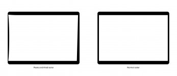

After watching techknight’s video regarding CRT Swaps, I was intrigued how easy it looks. After much consideration I’m thinking of performing something similar with an SE/30. However, one thing the video won’t explain is how exactly the knobs work (see attached image).
1. First of all, are they safe to touch with your bare hand?
2. There are eight knobs, but which knob affects exactly what part of the screen geometry?
3. Once moved/rotated are they stable, or do they need glue of som sort to stay fixed?
4. Two of them (2 and 3 in the attached image) seem hard to reach, how are they best dealt with?

– I have to touch them, the video have very annoying corner peaks and tilts.

Here is a representation of my raster problem.

I had to do those adjustments again because the cat broke the CRT neck on me Classic (not II)! The back case on top of the living room table and the Classic was right beneath the said table (I was working on it and since I have a carpet floor, it's very scratch proof, so I tend to work a lot on my knees). Cat jumped from there to the china closet and took the case along with him for a short ride. And guess where it fell? Yes, on the poor CRT's neck. It was a good CRT, in perfect health too. RIP in pepperoni. But hey I might use it for some hack some day (already have the hack in question in mind!)... I was properly sad that day, but now I've sorta recovered (the CRT hasn't  [🙁] ]'> )
Anyway... When I did the adjustments with the "new" CRT, I went bare hands (had one arm behind my back just to be sure and only one hand was allowed to touch the magnets.)
YOU HAVE TO BE REALLY FOCUSED ON WHAT YOU'RE DOING BUT if you are, then it's pretty easy.
Some tips: for the magnets labeled 2 and 3 in your PDF, I suggest using what bibilit already suggested: the mighty kebab sticks! Super useful when it comes to adjusting the potentiometers on the side of the Analog board too.
You just can't reach down, you're hand would be too close to some dangerous parts!
Just play around with the magnets, you'll find the right adjustment soon enough.
NB: If the whole display is tilted, move the whole yoke assembly but you can't do that while the unit is on.
