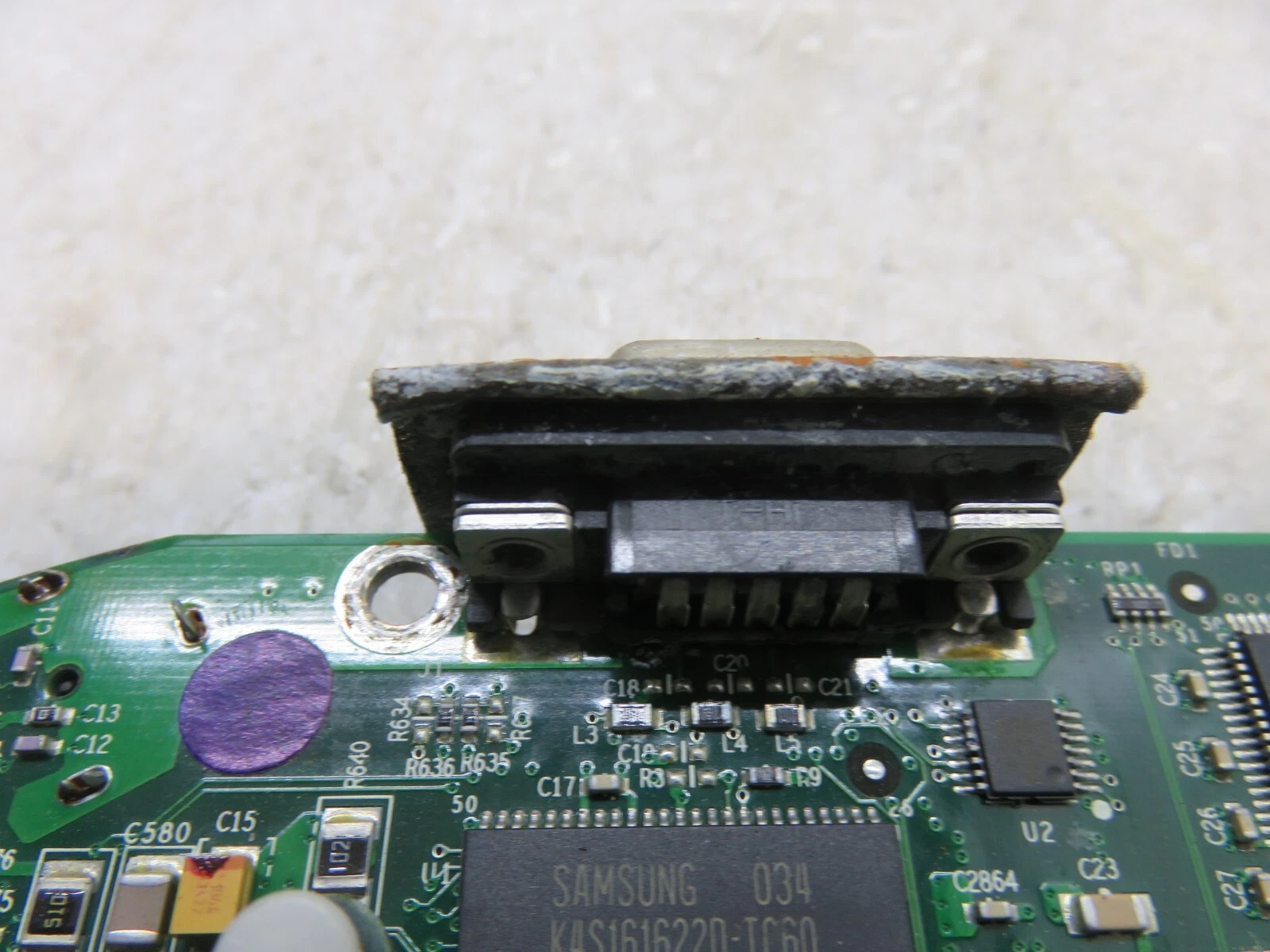

Posted by: Froggy814 on 2026-08-31 18:48:06
I found the pads @treellama was talking about. There are a bunch of components around it that are missing. Is there anyone that has a schematic for the G3 iMac or is there a willing person who can take their iMac apart and tell me what components I need to add and tell me the values. Otherwise I have to go on a whim... I don't want to do that!
Picture coming:
Posted by: Froggy814 on 2026-08-31 19:16:06
Alright here are some photos. If someone could help me to fill it out, that would be nice! 🙂
Posted by: Froggy814 on 2026-08-31 19:55:56
Here is a VGA picture from this ebay listing. It looks like they eliminated a part and just have 4 of the pins have things on them, do all of the pads need to be filled in then?
Ebay link
Posted by: Froggy814 on 2026-08-31 19:57:58
Alright, I would need the component values from a 400Mhz one. https://www.ebay.com/itm/3770038421...WiQfEp1dT11lxhdsojoJJzIg==|tkp:Bk9SR4SVmq6LaA
Posted by: Froggy814 on 2026-08-31 20:01:52
I want to know why ebay listings are the best place to get pictures!
Posted by: Froggy814 on 2026-08-31 20:16:12
Nevermind about the 400Mhz only. It's the 350 as well, maybe more. It does need to have that specific double chip layout though.
Posted by: Froggy814 on 2026-09-01 08:14:20
I have deduced with looking at pictures, in order to get VGA out of the board you need to add 2 resistors and 3 inductors. That looks like that's it. With the plug of course.
I think that the resistors are just 0 ohm, but the inductors and resistors I am not certain on what the values are. I will continue to surf the web. But boy is it hard to find info on these. All I see is pull the cannon. And I don't think anyone has attempted this before. @pl212 does your G3 have the VGA port with the Vram chips behind it? If it does do you think you can look at the values? Thanks!
