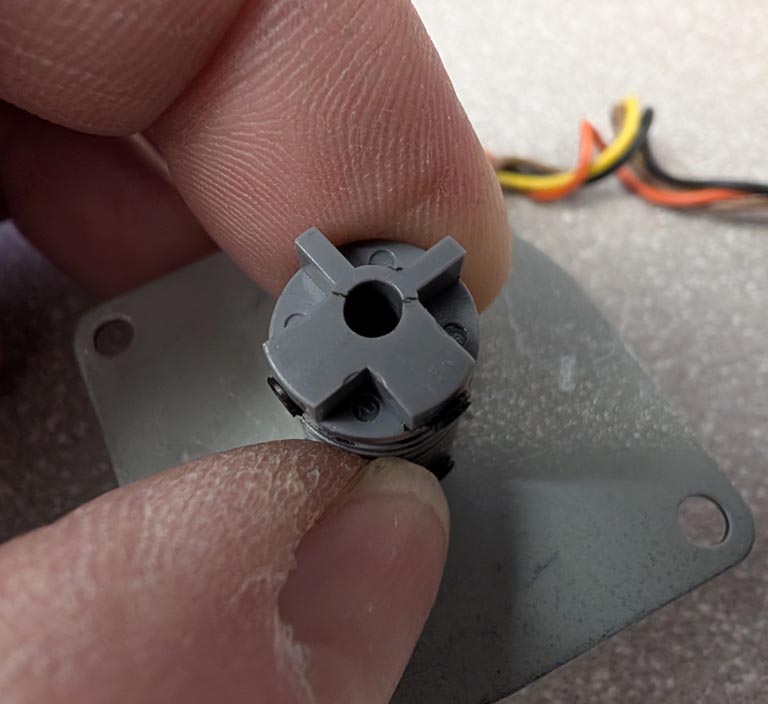

Skip forward a couple of days. While it was working at first, the stepper motor that drives the scanning carriage is now NOT turning the screw that moves the carriage. It turns out the plastic coupler is cracked on the end and the allen screws are not able to grab the motor shaft.
I think that drive was working originally, I went off on other tangents fixing things, and when the scanner started to actually scan a negative, that coupler finally broke loose. I just assumed that the scanner mechanism was moving and failed to notice that it had stopped moving. For now, I'm going to try heat-embedding a small metal wire ring in the end of the coupler to reinforce the area. I think it will be strong enough to do the job. It's made out of acetal or nylon, neither of which are easy to glue, so a mechanical solution is best. I haven't been able to find a plastic replacement for that part, only metal.
Posted by: ttyr2 on 2026-05-29 20:49:08
...and the fix that worked!
It's a clamp normally used for fuel line. I ground the tangs down so it would clear the housing, tightened the two set screws in the cracked part until the plastic flexed a bit, and then shifted the clamp over. It's pretty strong, and put enough pressure to grab the stepper motor shaft reliably. The scanner is 100% functional now.

Posted by: Phipli on 2026-05-31 02:35:41
Flexible drive couplings are pretty common, just need to find the right size.
You'll have to measure the shafts on yours.
