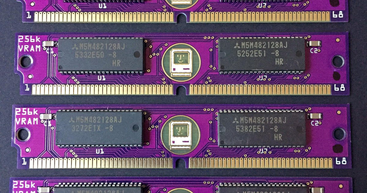

I have 2MB of Videoram but the System show up only 512kB of Videoram ...

Posted by: franklyn on 2026-03-19 10:17:26
I'm currently testing the 6 SIMM modules in pairs of 2 in my Performa 475 and one SIMM is defective. The lower half of the screen is faulty. Should I try resoldering the faulty SIMM?

Posted by: franklyn on 2026-03-19 11:26:54
I had no luck. One is faulty. I order a new one ...

I no longer have the paper/invoice, and reordering would be faster.
I've resoldered the faulty SIMM several times, even using HotAir, and I'm convinced that one of the two RAM chips is defective. These are all old parts, as they haven't been manufactured for over 30 years.

I ordered SQJ40 SMD sockets and soldered two of them onto the SIMM so I have a opportunity to test if and which chip is defective.
Question: Can I add another 512k chip to give the Quadra only 1MB of video RAM? And if so, which two of the six sockets do I need to use?

The Quadra 700 can only use 256k SIMMs. You can however have only 2x 256k to bring it to 1Mo.
Posted by: franklyn on 2026-03-21 08:24:02
Yes
Quadra has 512k video RAM onboard, and I would add another 512k (2x256k) ...
There are 6 SIMM slots, the question is, does it matter where I insert the other 2 SIMM modules?

B1 and B2 by the look of it.

Yes, they should be in the slots near the SCSI connector
