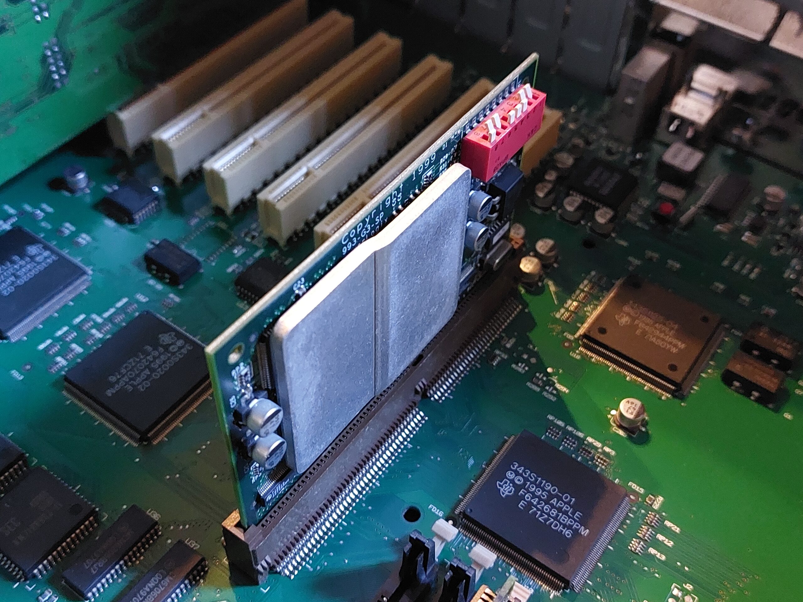

Noglin suggested that the graphics slowdown is due to the write buffers on the PPC/'040 bridge. Graphics writes likely use stfd instructions, which write 64-bit values, but these get broken down into 2x 32-bit writes, so even a single write fills 2 write buffers. Hence it functions as a bottleneck. He did numerous graphics tests which identified huge bus latencies depending on how much data was being shuffled and processed between caches and the '040 bus. The only issue with this is that it would have to be an issue with the 6200 setup specifically because the AV card used in the 6100, 7100 and 8100 also is a 32bit 040 bus with a bridge connected to a PPC 64bit host and that runs much much better. Not as good as 64bit and the HPV or even RAM based video on those machines, but several times over faster than 6200 video.
The AV card is basically the 840av video subsystem with a PPC->040 bridge 🙂 | Posted by: Phipli on 2026-02-07 02:51:45 Does anybody have a Performa 630 and a 66MHz PowerPC upgrade for it?
Logic being, that is also a PPC and an 040 bridge, onto the exact same chipset as a 6200. How does the video perform with that setup? What are the differences? We might be able to work out a bit more of what is going on.

Just checked my collection. I have (sadly?) three 6200 motherboards. All three have the newer ROM SIMM. Sorry.
No 630->PPC upgrade card either. | Posted by: zigzagjoe on 2026-02-07 10:37:16 It's important to remember that bus adaptation is never free. As they're running a half speed external bus on the PPC domain, there's going to be several clocks of delay required to recognize and handle the access on the PPC bus, negotiate for the bus on the 040 side, issue the relevant strobes (synchronously - incurring a delay), shuffle bytes around, translate acknowledges, and so on. The result being a PPC will never be as fast as a similarly clocked 040 when it comes to pure bus throughput.
At least the accelerator (PPC) and system clocks have a fixed phase relationship though. Adapting an 040 to an 030 bus ends up brutally expensive as the accelerator clock is typically uncoupled from the system bus, so everything needs to be double-synchronized on top of the requirements of the adapting the busses. Usually the improved 040 performance and external caches mask a lot of this in normal use, but for pure IO bound situations it's the same story: the adapted CPU never wins.
Even the best case scenario of a clock doubler for an 040 requires a few clocks "wasted" for syncronizing bus arbitration and transfer start strobes.
There are a few workarounds that can improve write performance, like a posted write buffer, but reads are going to always be rough when the cache misses. The worst case scenarios like modifying a single byte in uncachable memory (ie. Vram) as it always incurs the worst case delays as usually they require multiple full bus transfer cycles, often two for each pixel changed. That adds up *quick* regardless of how much faster the rest of the code to calculate what pixels need to be changed executes.
Compared to the 6100 which stored the framebuffer in 64-bit system DRAM on the native PPC bus, even with the constraints of having to share memory access with the CPU and video readout (FB to ramdac) it's a no contest win for the 6100. Gone are the days of the IIsi RBV bogarting 70% of the internal RAM bandwidth for video. | Posted by: Phipli on 2026-02-07 10:47:54
The worst case scenarios like modifying a single byte in uncachable memory (ie. Vram) as it always incurs the worst case delays as usually they require multiple full bus transfer cycles, often two for each pixel changed. That adds up *quick* regardless of how much faster the rest of the code to calculate what pixels need to be changed executes. That sounds very much like translating an image, which it is horrific at. So likely what we're seeing.
Compared to the 6100 which stored the framebuffer in 64-bit system DRAM on the native PPC bus, even with the constraints of having to share memory access with the CPU and video readout (FB to ramdac) it's a no contest win for the 6100. Keep in mind it is also terrible compared to a 650 with a PPC card and to a 6100 with an AV Card (which also uses a bridge to a 32bit 040 bus).
I really would love to see what happens with a PPC upgraded 630 - it should be almost exactly the same in terms of a block diagram as a 6200. Other than 601 Vs 603 and any settings / ROM specifics. | Posted by: zigzagjoe on 2026-02-08 09:20:56
I really would love to see what happens with a PPC upgraded 630 - it should be almost exactly the same in terms of a block diagram as a 6200. Other than 601 Vs 603 and any settings / ROM specifics. That is interesting. If they added a wait state on both the 040 bus side and the valkyrie's DRAM (VRAM) timing parameters, that would penalize things badly.
It could be enlightening to compare registers of the Valkyrie between a 6200 and 630. Or if @Arbee has the ERS hidden away somewhere 🙂 | Posted by: Snial on 2026-02-08 10:15:53
worst case scenarios like modifying a single byte in uncachable memory (ie. Vram) as it always incurs the worst case delays as usually they require multiple full bus transfer cycles, often two for each pixel changed. That adds up *quick* regardless of how much faster the rest of the code to calculate what pixels need to be changed executes. ( @Phipli ) it adds up, but there are a few reasons why I don't think that's the cause.
Firstly, there are no Read-Modify-Write memory instructions on a PowerPC, just load and store. So, this sequence of bus cycles in non-cached DRAM would have to be implemented in software, not the Capella bridge chip (load a 32-bit word to a register; insert the byte into the right position; write the long word back). But that doesn't make sense either, it would mean that the ROM had to consider the underlying PPC/'040 bridge.
Secondly, I don't think it makes sense to be implemented in Capella either. For cachable addresses, whole words get loaded into L2, then L1 cache - a block of 32 bytes (8 words) are loaded at a time and if a byte or half-word is modified there (which is now on the PPC side of course), the whole word (i.e. 8 words) would be written when the cache line needs to be flushed. So cacheable memory never needs an RMW sequence, nor a byte modification sequence.
Thirdly, from the developer note, it seems fairly clear that the interface between the 68040 bus to the PPC603 is a set of 543 latches:
So, I don't think it makes sense for Capella to emulate a byte store to uncached RAM to load an entire word into the D-latches from DRAM, then modify the intended byte, then write the 32-bit word back out. For byte loads it wouldn't matter, a PPC603 would still just load a 64-bit double-word and select the right byte.
It also makes little sense, given that the only way Capella can know if there's a non-cacheable byte write is if the PPC603 tells it. So, there are signals from the CPU for that purpose. It's far easier for DRAM to include byte line selects and simply pass those signals on. Even though the CPU will probably send out 64-bits + the byte select signals; Capella must know how to select the high or low 32-bit word, because DRAM is 32-bits wide. It must do that for normal writes anyway.
From page 8-15 it works like this:
A29-A31 (which are the low-order bits in the insane IBM convention), select the byte lane while the 3 signals TSIZ0:2 ==001, meaning 1 byte.
It's very easy for Capella to use this information to select the right byte lane in DRAM. A similar approach works for 16-bit and 32-bit read/writes:
Poor Video RAM performance is, I would deduce, for other reasons. | | 1 > |
