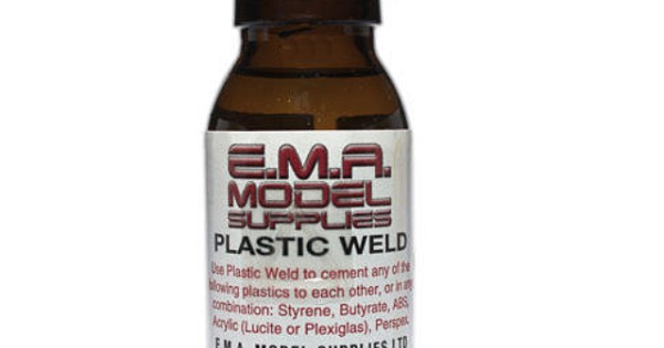

You need (I strongly recommend this specifically, not something similar or equivalent):
Known to experienced model makers as EMA Plasweld, this solvent sticks all normal model making plastics, i.e. perspex, ABS, butyrate, styrene, acrylic etc. It has a long shelf life, is fast acting (grabs in seconds), and has a water-like consistency so it is best used by holding or clamping the surf

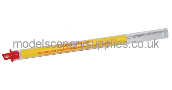

and something like this, or a very fine brush works ok too:
The Touch-N-Flow Applicator is a light-weight, easy-to-handle tool for applying liquid solvent cements. This product is gravity fed allowing an exact application of solvent cement according to the angle it’s held at. The Touch-N-Flow Applicator has the ability to; join seams wi

Also useful is some raw abs (abs printer filament works) and acetone to mix up some abs liquid/gel to reinforce joins on the inside.

I have order some EMA Plastic Weld Cement, and the filler can come from ABS filament, I already have from 3D Printing. | Posted by: Trash80toHP_Mini on 2026-01-22 12:50:03 Paint It, Black!
