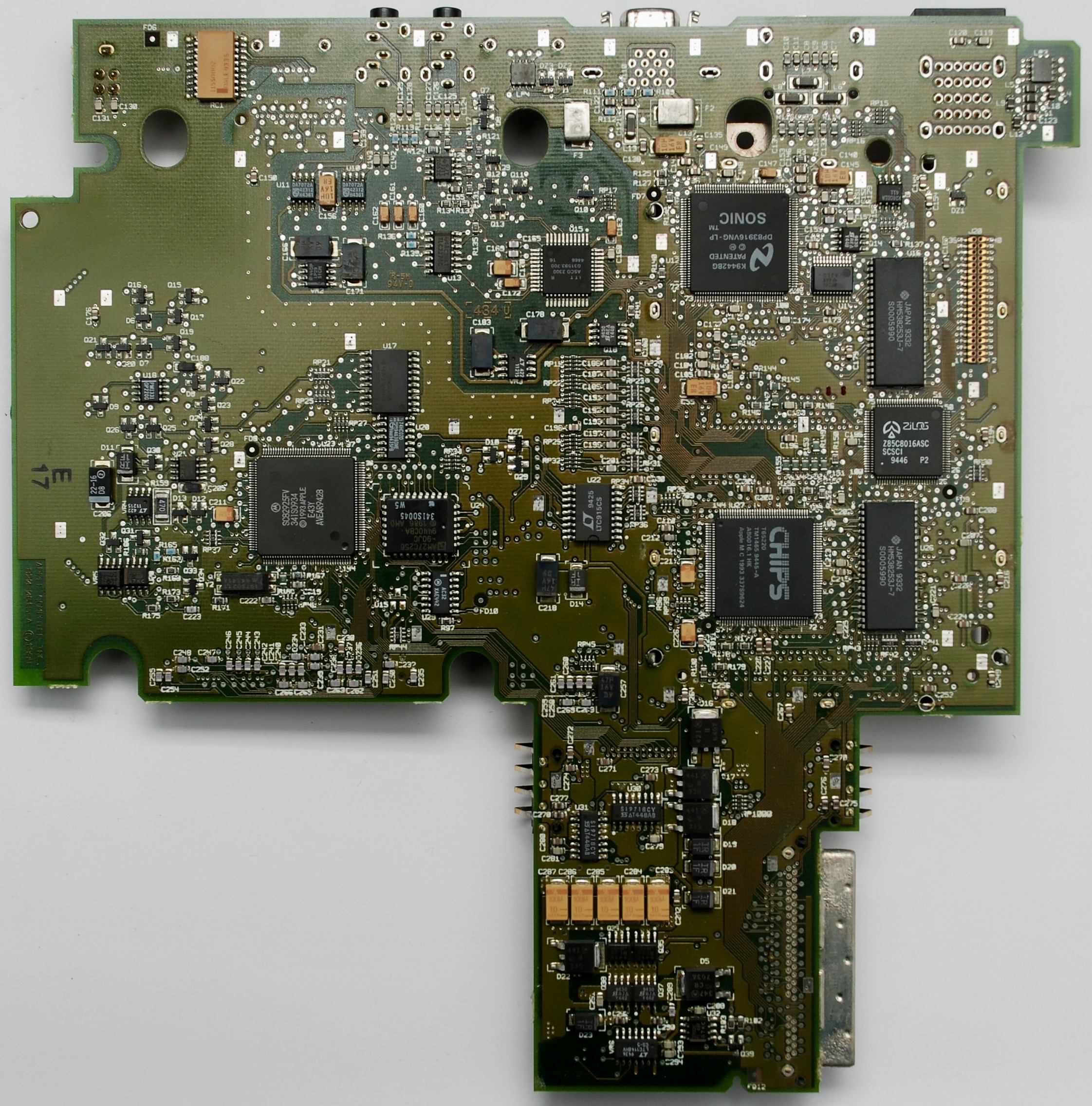

Hello,
This thread is mostly documentation. While probing on my lab board, I noticed that there is multiple revisions of boards around with major differences.
Is this something known ?
Having some minor revisions around is a common thing, but there it seems that there is a lot more going on in this series.
So far I've found the following differences
820-0456-B
- dated 1993, 1994
- has a Crystal CS4216 Audio Codec (same series used in a lot of beige PPCs)
- all of the components are on the bottom where the floppy drive is
- video memory is using TSOP II-40 chips, mostly on the bottom
- has ground pads for the floppy carrier on the PCB
- some were labelled 661-0054 "REV A"
820-0550-A
- dated 1994
- has an ASCO 2300 Audio Codec, which I believe is the one called "Singer" used in 660AV and 840AV Macs
- components are on both sides where the floppy drive is
- video memory is using SOJ-40 chips, top and bottom due to space issues
- doesn't have ground pads for the floppy carrier on the PCB
- some were labelled 661-0108 "REV B"
Other visible differences
- different battery management circuit
- due to different audio codecs, the sound support circuitry is different as well (except the excalibur op amp)
- the resistor pack layout for the LCD circuit is different
- most of the components, even if identical do have a different number
If you want to play the game, here is two pictures :
What's the reason for such differences ? Different OEMs ?

Posted by: croissantking on 2025-12-05 08:50:30
Adding photos of my 820-0456B into the mix. This is an early revision board.
The two OS-CON caps and battery charging contacts have been removed from this example.
Here's a reference for the two caps (taken before removal).
Posted by: croissantking on 2026-07-09 08:38:42
I've taken some better pics of this early revision board as my previous ones were decidedly awful. I'm using the same camera, so lighting is clearly everything.
Ignore the C&T 65225 IC I've soldered in, which is from a newer machine.
Posted by: demik on 2026-07-09 13:22:08
Very nice pictures, also good gob on that ECSC soldering…
Posted by: croissantking on 2026-07-09 13:37:56
Thanks! so I think we have good visual documentation of the four? five? board revisions now.
Notice that I’ve lifted about sixteen pins on the side nearest the VRAM, ready to accept flying wires. They are sooo close together though, I’m mad to even attempt this.
