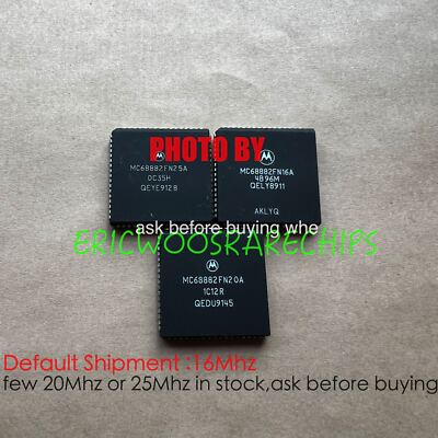

Posted by: jmacz on 2025-06-29 17:41:44 Eric Woo’s listings on eBay are legit. I have bought other chips from him and other members here have purchased from him as well.
But be careful and check the eBay ID as I have seen other sellers reusing Eric’s pictures. |
Posted by: shirsch on 2025-06-29 19:19:57 +1 on Eric Woo. I've bought a handful of CPUs from him and every one was gen-u-ine. |
Posted by: derFunkenstein on 2025-06-30 05:31:04 That's super helpful, thanks! I just sent him a message about a 25 MHz one, since his listing says to message before ordering. |

That's super helpful, thanks! I just sent him a message about a 25 MHz one, since his listing says to message before ordering. Yep, genuine chip was sent well packed to me too, I’d definitely recommend |
Posted by: cheesestraws on 2025-07-03 00:45:16 Eric Woo has an excellent reputation and the stuff I've previously got from him has been sound.
He's not immune to his suppliers sending him crap - but then who is? - but he seems to deal with that situation well when it occurs. And that's about al one can ask. |
Posted by: derFunkenstein on 2025-07-03 05:25:33 The email alert was a good reminder to follow up - I've got one from Eric on the way. Thanks everyone! |
Posted by: zigzagjoe on 2025-07-03 10:11:06 I have spent thousands of dollars with Eric and he's on the level. Second what cheesestraws said. |
