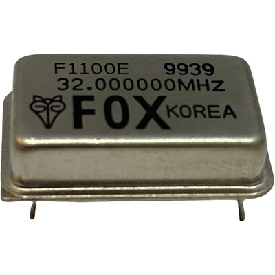

Posted by: robin-fo on 2025-05-07 02:09:18The SE/30 has a 31.3344MHz Oscillator and a 16.9344 Quartz on its Logic Board. Is it possible to swap these to 32.000MHz and 16 MHz parts or will the system become unstable?

Posted by: robin-fo on 2025-05-07 04:44:39I guess I simply have to try it.. The thing is, I really like the look of the FOX oscillators, but I can‘t find 31.3344 ones from them on eBay… 🙃
How funny - I don’t like the look of the Fox ones (but the little fox icon is cute). My favourite is the Saronix with black print.

Posted by: zigzagjoe on 2025-05-07 05:40:13Afaik, 32mhz is fine per @Bolle. No idea on the quartz.
Posted by: codevonlux on 2025-05-07 12:11:0416.9344 quartz is for the audio, if you change it then the sample rate like 11.025KHz/22.05KHz will change and will sound off.
Posted by: Arbee on 2025-05-09 10:35:16If you move the 31.3344 MHz crystal to 32 MHz everything should still work, except I'd be very wary of floppy I/O under those circumstances. It will probably work (particularly if you use only disks that were formatted with the faster crystal), but writing in particular could potentially fall off the timing window and wreck the disk.
