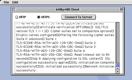

Posted by: wanderingjew on 2025-04-08 14:45:19
UPDATE: THIS WORKS NOW. TLS 1.2 NATIVELY COMPILED
A bit more screwing around, and this works now. I'm connecting to my server and getting data from the API. Take this as proof of concept for a working port of Mbed-TLS. This is running on a beige G3 with OS 8.6, compiled under Codewarrior Pro 4.
The issues I was facing:
Cipher suite problem: The client was only sending TLS_EMPTY_RENEGOTIATION_INFO_SCSV without any actual cipher suites. Because it presented no cipher suites, it could not negotiate a handshake. The actual error here was a sort of C89/90 memory error, where my array of ciphersuites was not being stored as data to be sent. Do you know the difference between const and static? I do, now.
Elliptic Curve Configuration: This was similar; there was an error in the way the compiler read my array of curves. Const and static issue. Also, now I'm only supporting one curve, MBEDTLS_ECP_DP_SECP256R1, this is sufficient to complete a handshake.
Memory allocation failure: Once I had the cipher suite config, I was hit with another error, MBEDTLS_ERR_SSL_ALLOC_FAILED (-24192). This occurred when trying to add the elliptic curves to the ClientHello message. There are two ways to go about this; defining a gigantic buffer and calloc and freeing it into the SSLState struct, or by letting the config do that for you. By adding MBEDTLS_MEMORY_BUFFER_ALLOC_C to the config and adding mbedtls_memory_buffer_alloc_init() somewhere in the initialization, I got this to work. The Elliptic curves worked.
TLS Protocol Version: It works better with TLS 1.1, but this is really my first pass at this. Now that it works and I know what to look for, I can debug TLS 1.2
I'm still going to work on this until I can change the api.h to point to any API endpoint, and the JSON is printed to the text box. But this works now. I'll update this thread, and hopefully have something working up on Github later.

IT WORKS This is JSON pulled off of my server at this endpoint: https://640by480.com/api/v1/posts
I'm going to clean this up and do a complete writeup, and eventually package this as a 'lightweight bare-bones project' for other people to hack on.
Few updates from the last time I updated -- I added a 'debug file' thing, where all the data is written to the textbox (32k limit), AND a text file in the same location as where the program is run from. This doesn't have a 32k limit, and it's easier to debug. The rest of the work was just getting the configs right and testing, testing, testing.
I'll spend a few days on this and have a proper github release.
