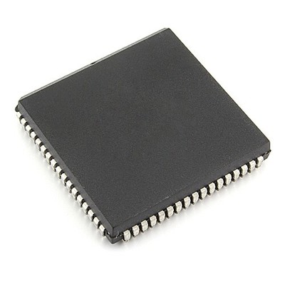

More research, the SiliconExpress IV has a QLogic scsi chip. Turns out QLogic was a spin off of Emulex in 1992. There are QLogic FAS101 parts:
SCSI processor, ESP100A pin co...
shop.tvsat.com.pl
MPN: FAS101. Case: PLCC68. SCSI Processor. Manufactured: QLOGIC.
www.ebay.com
