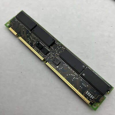

hello, i'm rather curious about your all's experience with 168pin EDO DIMMs, and what upgrades people have made to the RAM in the powermac 6400. i would love to get 264MB of RAM (2x 128MB plus the 8mb onboard). apparently the 6400 supports 1k or 2k refresh, and the service manual specifically says not to use 4k refresh. now i'm curious about what the PSX memory controller is *really* capable of, especially considering i found a post on applefritter that had a reply of someone saying they had 264 in both their 6400 and 6500 (256). (https://www.applefritter.com/comment/29251)
you'll see a 'macg4' has two of these machines with more than the maximum amount of RAM thats widely documented. also, the page for the performa 6360, for whatever reason, mentions having a max capacity of 264MB (and the 6360 is the same as the 6400, technically). yes, i shouldn't believe everything i see on the internet, but it got me thinking about pushing the limits of these nifty systems. we already got the bus overclocked in a stable fashion and such, which is amazing... what really interests me is how far we can go. has anyone ever bothered testing 128MB EDO DIMMs in these systems? and i did see people on tinkerdifferent found 3.3v DIMMs that were also 5V tolerant, which interests me. mainly the reason why i made this thread is because i have been doom-scrolling eBay for a better deal on the best memory for my 6400, especially considering the systems memory at the moment is having corruption issues.
Posted by: obsolete on 2024-12-25 19:52:27
I put a pair of these in my 5400: https://www.ebay.com/itm/174327966152
Kinda boring, I guess, but they just work.
Posted by: Byrd on 2024-12-25 20:08:57
Recalling trying a single 128MB stick in a 5400 and also TAM, didn't like it, 2 x 64MB was the max
Posted by: alectrona6400 on 2024-12-25 20:33:15
submitted a $20 each offer for two DIMMs (total $40 before tax) and now i await the response. not the prices i wish for but better than $60 or something. i need new RAM in this machine.
do you have the exact model number of the stick used? couldve been 4k/8k refresh but i'm not so sure 128MB DIMMs exist with 2K refresh.

Does anyone know if RAM chips with memory density higher then 2MB were made in the "form factor" that would work with the 6500's four unused on-board memory pads?
These somewhat larger than typical RAM IC have 42 pins, you can find DIMMs on eBay that look like they would fit but they all seem to be composed of 2MB chips, 4 chips = 8MB DIMM and 8 chips (aka "double sided") = 16MB DIMM.
Example 16MB DIMM with 8 x 2MB RAM ICs:
Would be cool to be able to add more than 8MB to the logic board.
Posted by: Fizzbinn on 2024-12-29 17:53:22
