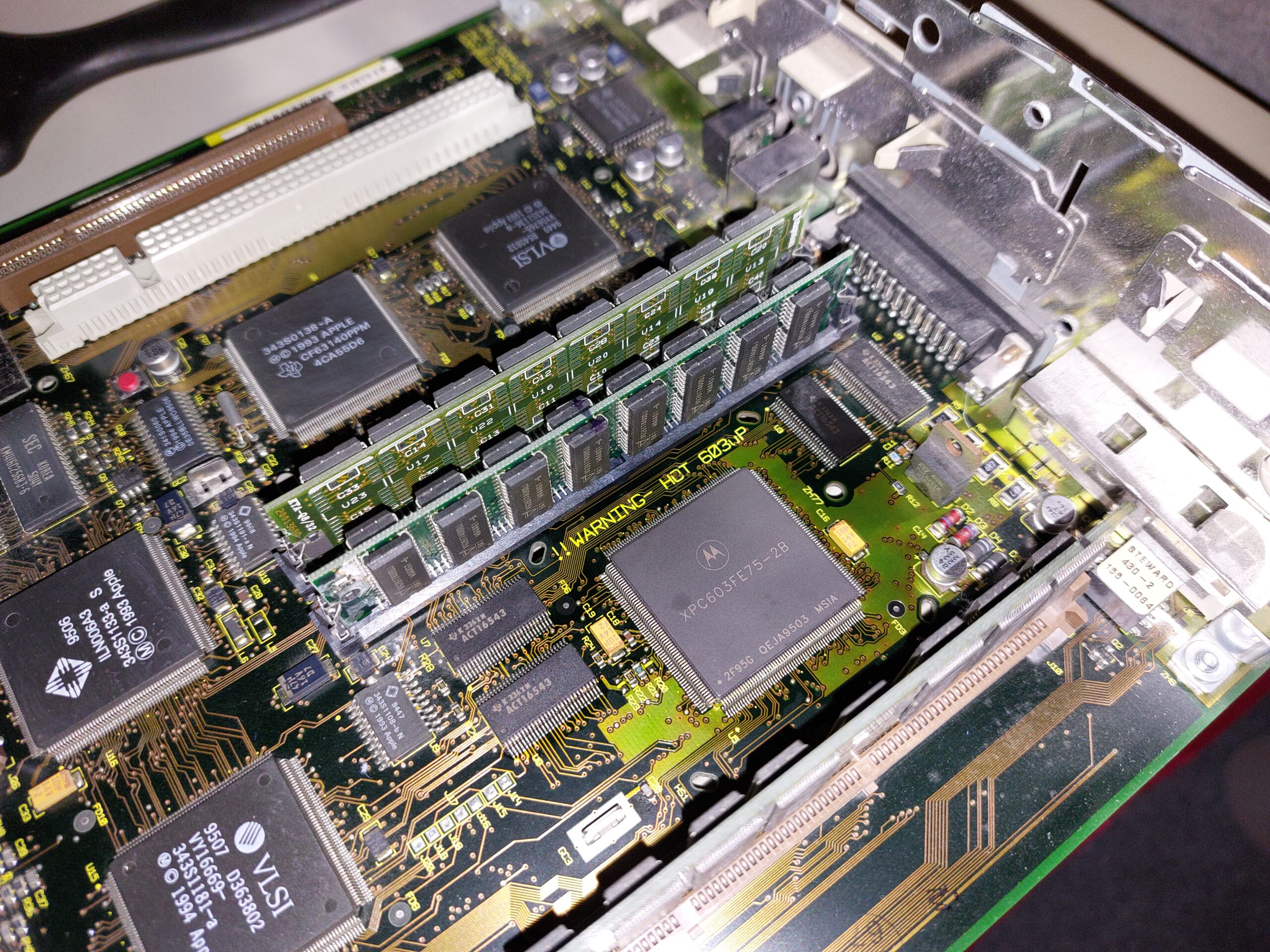

I have a CF/IDE in my 640, and dual boot between 7.5.x and 8.1. The two SIMM 630 (like my 640) can go to 52 MB: 32 + 16 + 4 |
Posted by: begeve on 2024-09-23 11:44:46 Just opened the 630 and it indeed has two simm slots. So I'm going to max out at 52mb. Very nice! I thought the CD drive was broken but after some careful checking connections it works again which is very nice as well.

Posted by: pizzigri on 2024-09-24 08:40:30 I have a 630 with two 64 mb simms in it. Be advised that the second slot only takes single sided memory simms, so you’re limited to 64mb in the second slot and 128 in the first. I did not try 64+128 as I don’t have a 72pin simm in this size, however the two single sided 64 i have work great in this machine. The two simm slot version of that board accounts for possibly 30% of the total 630 machines made and is highly sought after sometimes commanding 20-30% more that the standard LB.
i think it was built for the “DOS compatible“ machine although some bare boards show up in random 630’s. |
