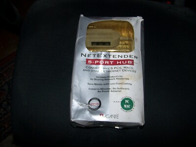

Sure, other than the somewhat unique (cool IMHO) way it connects to and is powered by one host via AAUI it’s just an Ethernet hub.
I wonder if Asante manufactured this for Apple, it’s a lot like their “NetEXtender 5 Port Hub“ just with AAUI instead of AUI:
