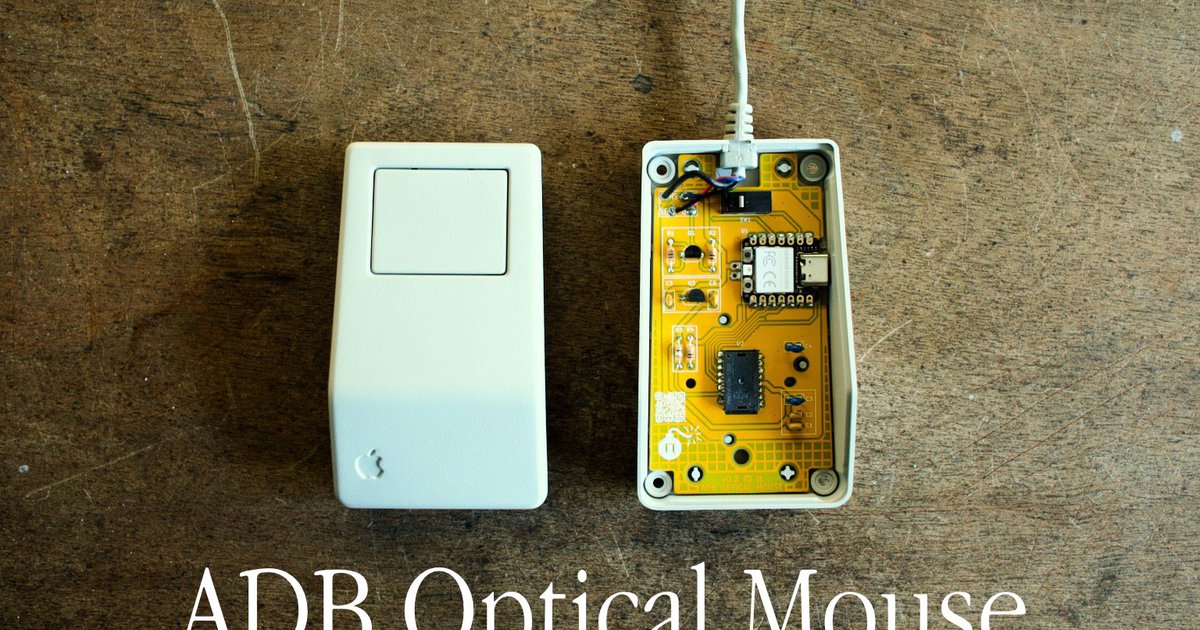

But I'm still deciding whether to use the internal components of the M0110 or make everything from scratch.
What if you did something like this?
Posted by: calvinchu1999 on 2025-04-24 21:47:36
Well, actually I'm thinking of making everything the same as original, but it depends on whether I can still get all the parts.
