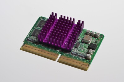

Posted by: Fizzbinn on 2024-08-26 10:52:23
I think ones like this from Sonnet might be the lowest profile:

Posted by: Trash80toHP_Mini on 2024-08-26 13:51:39
Remembered where the Cache of 1MB Cache equipped Sonnet cards were! I've got that 450MHz above and a 500MHz/1M G3 Crescendo card so all is good for a 2U9500/G3 build.
Bad news though, neither the 400MHz/1M nor the 800MHz/1M G4 Crescendos will clear the lid of a 2U box, just a tad too tall. The 800MHz beaut has a nifty fan on the heatsink. That'll have to go into the 4UPEx/Netra-t RackMonster that's already in progress as planned.
Can't believe I forgot all about everything but the 800MHz/1M G4, soooo glad I hit Sonnet's NOS clearance event with a vengeance! 😃
