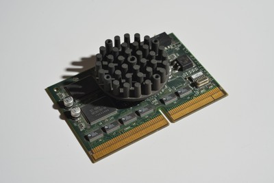

Posted by: _AP on 2024-07-31 22:44:02 Hi. I have a PowerCenter Pro 210.(PowerMacintosh 7200)
It has the Catalyst motherboard, and supposedly goes up to a 60MHz bus officially according to my research.
I installed a Sonnet G3 450/1M. It all seems to work fine, but the bus runs at 45. (Makes sense 45 x 10). I was wondering if it's possible to have it run at a higher bus speed. |

Posted by: Byrd on 2024-08-01 14:50:38 Sonnet cards were pretty vanilla in the day with their upgrades often going for conservative bus settings for broader compatibility. I suppose most are still around and working which is good. You probably want any other brand with a DIP switch setting to experiment with bus speeds, notably the XLR8 MACH speed carrier card. |

Posted by: Franklinstein on 2024-10-18 11:56:42 Sonnet's slogan is (or was) "No switches. No control panels. Simply fast." So their products are generally fixed and/or auto-configurating drop-ins. Apple slot CPUs have fixed oscillators on them that generate the bus speed, so it stands to reason that Sonnet cards do, too. This is how you can drop a 120, 132, or 150MHz CPU into the same machine (like an 8500) and it "just works:" the CPU dictates the necessary bus speed. Because Sonnet wants their products to go into as many systems as possible, they design for a middle ground, which in this case is a 45MHz bus. Most Macs and their installed RAM and peripherals will run stably at that speed. |

Posted by: pathw on 2024-11-19 19:15:51 I have an XLR8 MACh Speed G3 in a PowerComputing PowerTower (was 180). According to the XLR8 Control Panel I have the bus running at 58.2 MHz. TechTool confirms that the bus is running at 58 MHz. (Processor is at 465.4 MHz; backside cache at 155.1 MHz). |
