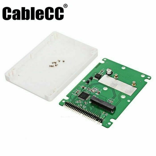

Posted by: BespokeMan on 2024-07-25 01:43:55 Does your mSATA SSD in those el cheapo adapters overheat? My Mac Mini G4 sleeps (and eventually shuts down) after getting too warm. |
Posted by: davecom on 2024-07-25 02:05:49
Does your mSATA SSD in those el cheapo adapters overheat? My Mac Mini G4 sleeps (and eventually shuts down) after getting too warm. Can you link to the specific adapter you’re using?
But no, I’ve only seen overheating on minis that were either not thoroughly cleaned, had a blocked airway for some reason, missing heat sink pin, or fan improperly installed. The SSDs actually reduce the likelihood of overheating. But maybe you’re using a different adapter than I use on the 20+ I’ve converted… |
Posted by: BespokeMan on 2024-07-25 03:25:48
But no, I’ve only seen overheating on minis that were either not thoroughly cleaned, had a blocked airway for some reason, missing heat sink pin, or fan improperly installed. The SSDs actually reduce the likelihood of overheating. But maybe you’re using a different adapter than I use on the 20+ I’ve converted… Generic one from China with the JM20330 controller. I didn’t purchase it off of Amazon but it’s most likely the same as those that sell for around USD 13. |
Posted by: davecom on 2024-07-25 05:00:07
Generic one from China with the JM20330 controller. I didn’t purchase it off of Amazon but it’s most likely the same as those that sell for around USD 13. Can you show a picture? Many have JM20330 but they’re not all the same. |
Posted by: BespokeMan on 2024-07-25 05:23:28 Here's what I use |
Posted by: davecom on 2024-07-25 06:33:25 Thanks. I haven't had particular experience with that adapter, but it does look like the same ICs with a different metal heat shield than the one I use. I've had very good success with the cablecc product with the white case (also available under other brands). But as I wrote above I doubt the SSD is the cause of the overheating.
Here is the adapter I use on Amazon:
And here it is on eBay:
Find many great new & used options and get the best deals for Cablecc mSATA mini PCI-E SATA SSD to 2.5 inch IDE 44pin Notebook Laptop HDD SATA at the best online prices at eBay! Free shipping for many products!
www.ebay.com
