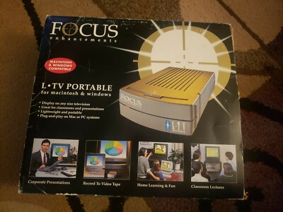

Posted by: Phipli on 2024-04-09 06:44:14 Have you considered one of these, or the apple branded equivalent?
Used but great shape.
www.ebay.com
or
Zenith View All PC/Mac to TV Link Up PCZ150. See pics for more details. Just send us a picture. It was all so easy. Brown (#283419346331). Sunbeam Oskar Mini Food Processor Chopper Model 14081 Off White Made In France (#283419361911).
www.ebay.com
