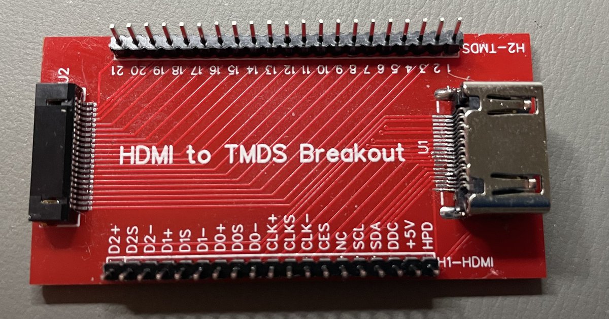

Seems to be a lot of folks wanting to re-use the Sunflower G4s, hooking up outside video, replacing the guts with an M1 Mac mini etc,
I thought I'd create a breakout board where you could pluck the video plug off the mother board, plug it into the breakout board and route the signals using lots of the data sheets available online, I'd also be open to sell premade adapters for specific models if there is adequate demand.
I'll have them listed on Tindie in a few days.
Please let me know your thoughts.

Cool project! Do you know if this PCB is compatible with all models of iMac G4, or only specific ones? Does using converter PCB mean that no wires need to be cut during the iMac conversion process?
It sounds like I would need to desolder the SMD connector from my iMac's logic board and then solder it onto this new PCB. Is that correct? Any idea if there a commercial source for this connector?
I look forward to converting my iMac G4 into a monitor someday!
This is not a converter, its a breakout board.
On one end is the elusive TMDS connector that Apple uses on the motherboard of all the G4 sunflower macs.
On the other end is the HDMI connector
In between are pins that you interconnect to make it work.
Correct yu do not need to cut the end off the video cable.
No desoldering is required, you just carefully unplug the cable from the motherboard and plug it into the breakout board.

Do you have a diagram to what pins need to be connected where or are they already aligned so that you just go straight across for the signal on a G4 imac screen? I bought your board awhile ago but couldn't find much clear information on what pin goes where for a 17" imac g4 display

It says on the left: "20 - connects to: DDC - 16" – but the right side says DDC is 17, with 16 being SDA.
