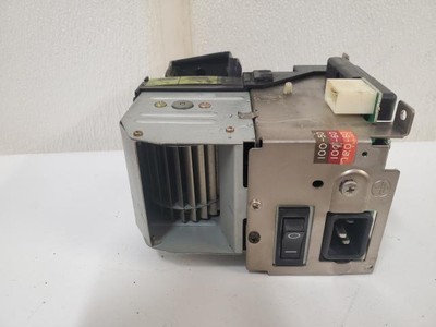

Posted by: NJRoadfan on 2024-03-06 16:47:49 Two red flashing lights is either a power supply problem or a fuser problem on these. Both are very common issues on SX engine printers. Equivalent to HP LaserJet II's ERROR 50. Used to be that both parts were easily sourced and swapped out, but that likely isn't the case anymore. |
Posted by: ScutBoy on 2024-03-07 04:54:35 Very likely a bad power supply block. Not hard to replace. It's the same part as used in HP Laserjets of the period. My old notes say these are the suitable part numbers. Of course, you can recap/repair the one you have.
RG9-0205
RG9-0319
HP SX-ACPM-B |
Posted by: joeventura on 2024-03-07 06:34:49 This is not my auction, but this is likely what you need:
Find many great new & used options and get the best deals for Japan Servo RH7-1047 Fan Blower Assembly HP Laserjet II/III Power Supply at the best online prices at eBay! Free shipping for many products!
www.ebay.com
Having refurbed a bunch of these, this component is bad 80% of the time. |

Posted by: pezter22 on 2024-03-28 16:45:57 I installed the Top Cover Interlock switch today on the DC Power Supply and I am still missing the 24v power circuit. Tomorrow I will install a new Triac on the AC Power block. I am reading good steady 80 ohms. On my other AC Power block I was getting random readings.
Thankfully parts are still available. I found a DC Power Supply and a Fuser Assembly and will replace them. But I can't keep throwing parts into this either.
I just find it frustrating not being able to find why it's not generating the needed 24v to the Fuser Assembly. It does plug directly into the AC Power block, which I am hoping replacing the Triac will work...

Posted by: pezter22 on 2024-04-11 17:24:32 Progress today. I have a steady green light.
Previously I wasn't getting 24v anywhere on the printer. I 68kmla member Joe Ventura provided me with a replacement AC Power Block and I purchased a replacement DC Power Supply and the printer finally woke up.
