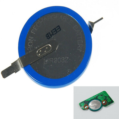

I once tried the oven baking method, it worked but not for very long..I dont know if a Pro-reballing is worth it? | Posted by: pbertolo on 2024-03-01 23:55:21 First off, the PRAM battery had to be replaced, as totally dead. Power management behaving totally erratically. Curiously, the optical unit was also affected.
Original item: Panasonic CGL3032, Li ion 3.7V rechargeable battery.
Impossible to source an exact spare, seems like it has never been available for retail. Some shops on eBay offer working spares (including the board), but at hefty prices. Additionally, shipment is not always granted due to risks connected to Li ion batteries.
Luckily, where I live (in Japan) there's an online shop that is selling a custom made spare they get produced on purpose in China.
Still on the expensive side (around 25 USD), but all in all more than acceptable.
View attachment 70645 Sure they're not cheaper somewhere?
Locally, we have these :
The pins are for horizontal mounting on a PCB. It results in significantly higher energy density than NiCd and NiMH batteries. Have proved useful in refurbishing Fossil PDA watches and Apple Power Book PRAM battery assembly (Apple part number: 922-6714, 922-6711, 922-4631 etc).
www.ebay.co.uk
Tabbed LIR3032 batteries aren't a unique part to Apple. | Posted by: pbertolo on 2024-03-02 00:22:08 Yes they are cheaper and I saw that, but the ad reads they won't be shipped to Japan. | Posted by: pbertolo on 2024-03-02 05:39:06 Anyhow, still behaving totally erratically. The main battery is dead, but there's no way I can power it up using only the external power supply (65W).
