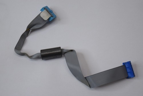

Posted by: jexus on 2024-01-28 22:36:21 Hi, i'm searching for a video cable for non backlit mac portable. I only find replacement/solutions for the backlit version. Any suggestion? thanks |
Posted by: wottle on 2024-01-29 08:58:04 Unfortunately I think that is the one variant Androda doesn't make. Might be worth reaching out and seeing if he would be willing to add it to his flex cable recreations. https://androda.work/product-category/macportable/ |
Posted by: SuperSVGA on 2024-01-29 10:18:17 You could likely build your own cable just by crimping the connectors on, but I don't know of a source for the display side connector unfortunately. |
Posted by: jexus on 2024-01-29 16:52:14
Unfortunately I think that is the one variant Androda doesn't make. Might be worth reaching out and seeing if he would be willing to add it to his flex cable recreations. https://androda.work/product-category/macportable/ Thanks |
Posted by: jexus on 2024-01-29 16:55:00
You could likely build your own cable just by crimping the connectors on, but I don't know of a source for the display side connector unfortunately. Yeah that's the problem. I can't find the display connector on the vendor website |
Posted by: SuperSVGA on 2024-01-30 15:02:24
Yeah that's the problem. I can't find the display connector on the vendor website That's the odd part, they have the bigger version which seems to be identical in everything but size, but no sign of the smaller one even existing even going back to older catalogs.
It's possible something like HARTING 15290262501000 or 15290262502000 might fit (or be modified to fit) but I don't have any on hand to test. |
Posted by: jexus on 2024-01-30 16:43:40
It's possible something like HARTING 15290262501000 or 15290262502000 might fit (or be modified to fit) but I don't have any on hand to test. Unfortunately i know.. i took the bigger version from usa (i'm in europe) and when the package arrived... surprise! I'm start to thinking of soldering wires one by one directly on the display pins. It's a shame my portable can't live anymore because of a stupid cable |
Posted by: SuperSVGA on 2024-01-31 06:24:04
Unfortunately i know.. i took the bigger version from usa (i'm in europe) and when the package arrived... surprise! I'm start to thinking of soldering wires one by one directly on the display pins. It's a shame my portable can't live anymore because of a stupid cable Well if you can desolder the connector on the display board you could probably use a direct board IDC crimp like 3240-26-00, M50-3801342, or FFMD-13-01. The cable wouldn't be detachable from the display anymore but at least the other end would still be. |
Posted by: jexus on 2024-01-31 07:42:18
Well if you can desolder the connector on the display board you could probably use a direct board IDC crimp like 3240-26-00, M50-3801342, or FFMD-13-01. The cable wouldn't be detachable from the display anymore but at least the other end would still be. yes, i can desolder the connector. Thanks for the info, i'll let you know. |
Posted by: mg.man on 2024-02-02 03:59:40
Find many great new & used options and get the best deals for Apple Macintosh Portable 5120 LCD Screen Display Ribbon Cable at the best online prices at eBay! Free delivery for many products.
www.ebay.co.uk
Posted by: jexus on 2024-02-21 20:39:20
www.ebay.co.uk
it's a shame.. i'm in europe and the postage is 86 dollars.. thanks anyway |
Posted by: mg.man on 2024-02-21 23:44:50
it's a shame.. i'm in europe and the postage is 86 dollars.. thanks anyway Drop me a DM, I may be able to help. |
Posted by: jexus on 2024-02-23 09:50:24
Drop me a DM, I may be able to help. Done |
