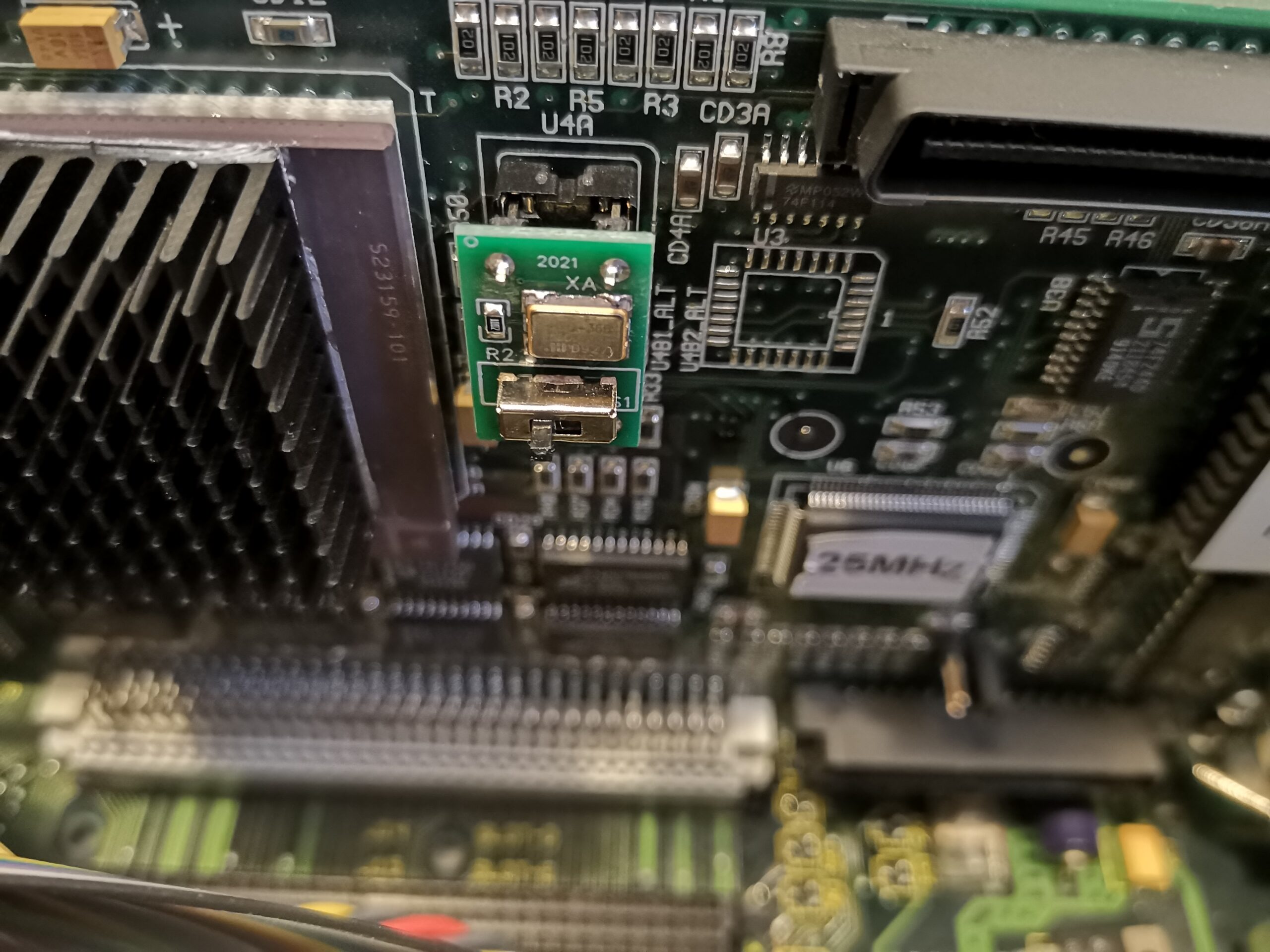

Sorry if these tangents are irritating, can't help myself during caffeine deprived phase of wakeup routine. 😳 | Posted by: jmacz on 2025-07-07 00:02:12 Are there any differences in hardware for the stage 1 cards: the 25i vs the 33?
Could you swap in a 33MHz rated full 68040, change the crystal (I think it’s a 50MHz can vs a 66MHz can), and drop in a 27C256 eprom flashed with the 33 rom dumps in this thread to turn a 25i into a 33? | Posted by: cheesestraws on 2025-07-07 00:09:57 Yes, @Phipli did this a few years ago:
Upgrading the Radius Rocket 25i In the early 90s before Apple was able to release the first 68040 based Quadra system, Radius, mostly known for their video cards and monitors but also a manufacture…
elephantandchicken.co.uk
Perfect, thanks! | | 1 |
