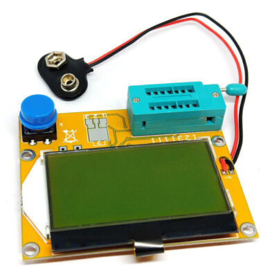

I think my next step will be to rig up a proper Mouser order this afternoon and buy a fresh set of caps straight from the source. If nothing else, this project has given me some more reps in the soldering department, never a bad thing. I don't think you should do this. It is cheaper to buy a cap tester and replace any that are bad, but truth is, the issue is far more likely to be something other than a faulty new part. |
Posted by: Phipli on 2024-01-20 12:37:27
Inductance: 0.01mH-20H. Automatic detection of NPN and PNP transistors, n-channel and p-channel MOSFET, diode (including double diode), thyristor, transistor, resistor and capacitor and other components.
www.ebay.com
