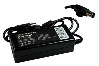

Posted by: Shaddam IV on 2024-01-18 00:53:22 Perhaps this? It's made for Germany but I'm sure you'll find similar offers in other countries.
Kompatibles Netzteil/Ladegerät. Das Netzkabel hat einen versiegelten Stecker. Apple PowerBook Duo 230.
www.ebay.de
