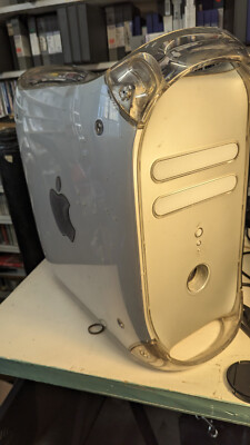

Posted by: Plasticoat on 2023-12-28 00:52:31 This is how I began my journey, no one was able or willing to repair my classic, so it began…
I have 2 PSU for a G4 , after years I have started to map and remove old capacitors, but it may take another 2 years before I have completed the job.
In between jobs I have a quicksilver to tide me over so I’m in no rush, this listing may help it’s £1
This Apple Power Mac G4 desktop computer is being sold for spares or repairs. Please note that the hard drive has failed and is not included. The computer may have other issues and is being sold as-is. This tower model was released in 1999 and features a PowerPC G4 processor and ATI Rage 128...
www.ebay.co.uk
Start the journey, you never know where it will take you |
