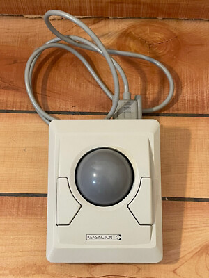

Posted by: joeventura on 2024-02-03 16:21:05
It's called the Kensington Turbo Mouse Plus. I have one which I use with the Lisa, pics here: https://68kmla.org/bb/index.php?threads/kensington-turbo-mice-a-tale-of-two-trackballs.36554/
Note that the very first generation of Turbo Mouse is basically a rebadged Affinity trackball and if it's like the other Affinity trackballs isn't very good. There's one of those on eBay at the moment, if you want to actually use it as a trackball I'd avoid it. You can tell it because it has rectangular buttons at the bottom and a captive ball. I'd wait for the one that looks like the one on my thread, which is basically the same as the early ADB ones with a different interface on the back.
The other option is that you can get a PC one and rewire it. I haven't done this for the Plus but I've done it for the Acorns which also use quadrature mice - can send you details for what I did if you want to get a-hackin'. Is this one?
<p>Vintage Kensington Model #62358 Turbo Mouse Plus</p><p>Check the pictures for more physical details </p><p>Good condition </p><p>Works great 👍 </p>
www.ebay.com
Posted by: cheesestraws on 2024-02-03 16:24:36
Is this one?
I just DMed you about that one 🙂 I think so, yes - the seller has the cable the wrong way around, the mini-DIN goes into the back of the trackball and the D-type goes into the back of the Mac. The D-type on the trackball is for a passthrough mouse.
That said, it's possible that that one is a mislabelled serial one, since we can't see what the plug is, and I don't know whether that's the right model number. But the odds are fairly good... |
Posted by: joeventura on 2024-02-09 17:52:08 It arrived and it works.... sort of.
As you know there are three rollers inside, and X and a Y axis and then there is a third that sits at about 7 oclock.
It seems to not want to turn, it is inside two rubber grommets and Im wondering if its supposed to spin freely because it seems locke dup 100% to the axle it runs on.
Anyone have any knowledge?
Also. there is a set of config switches inside, anyone know their purpose? |
