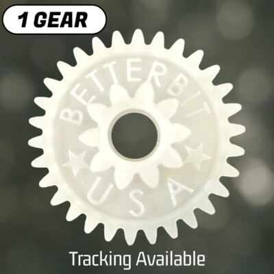

video showing the issue Yeah, sounds like the gear failed.
You'll want to find a gear for an 800k floppy and fit it.
Perhaps this :
The goal again is to further drive down prices for hobbyists. Many of the gears you see listed for sale originate from my design.
www.ebay.co.uk
Or this :
I don't have experience with either, but you'll want to clean and lubricate the drive at the same time. There are several videos on how in YouTube. |

I don't have experience with either, but you'll want to clean and lubricate the drive at the same time. There are several videos on how in YouTube. Excellent. Thank you for the confirmation that was the issue and for the links. I'll get those ordered and hope for the best😉 |

Posted by: cendrick on 2023-12-10 12:18:51 Update:
Hello everyone. My repair is going well. Took the mac case off, took of the floppy drive and found the stripped gear. See photos below. I now have a new issue. As I was cleaning the drive, I took the extra initiative to clean the lower plate but one of the metal clips flew off the stud and is nowhere to be found. Any ideas on how to replace this?
