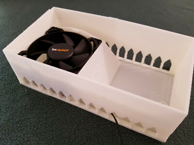

Posted by: ymk on 2023-10-19 18:30:55 If you're interested in quieting a Classic II, I sell this air box, which allows you to mount an 80mm fan:
This 3D printed air box replaces the factory air box in the Classic or Classic II. It mounts a standard 80x25mm fan for improved airflow and reduced noise. In addition to the bottom vents, this air box also draws air in from the front of the case.

That's amazing! should it be the 3-pin or 4-pin if I want to power this straight from the hard drive power molex? Would you have a video of the assembly? What's your estimated shipping time to the UK? I'm ready to order! |
On a Noctua fan, the third pin (RPM/green) and fourth pin (PWM/blue) won't be used in your Mac.
Many Molex adapters will accept either a 3 or 4 wire fan.
I don't have an assembly video. It'll ship next day, so expect it to arrive within two weeks. |
