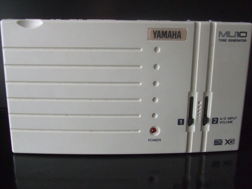

Posted by: Phipli on 2023-10-02 07:13:04 Or a Tone Generator!
Find many great new & used options and get the best deals for Yamaha MU10 MIDI Tone Generator circa 1997. Working, slider noisy, some marks at the best online prices at eBay! Free delivery for many products.
www.ebay.co.uk
