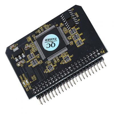

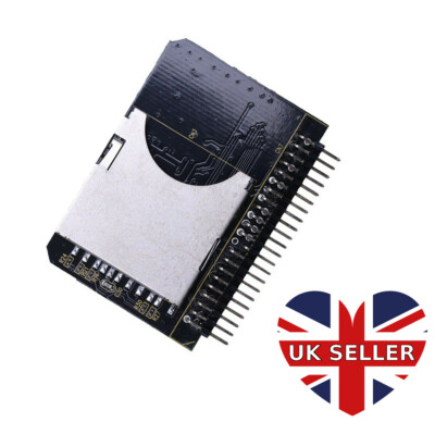

IDE to SD card? Is an SD card actually going to be fast enough? I've had excellent luck with specific SD card adapters in my Pismos. They are way faster than the original hard disks. I've used them regularly for several years.
IDE interface: 44PIN. Support SD card type: SD card, SDHC, SDXC,, TF. This adapter card allows you to use the SD card with this superiority to connect to the standard ATA IDE interface as a standard IDE storage device.
www.ebay.co.uk
Or claiming to be in the UK
It also provides a convenient way of transferring data between old and new computers. No extra software or drivers are needed as it will be recognised by the computer as if it were a standard IDE hard disk at whatever the capacity of the SD Card is.
www.ebay.co.uk
You'll need to make something to hold them and stop them shorting. Mine are just covered in kapton tape. But don't tell anyone. |
