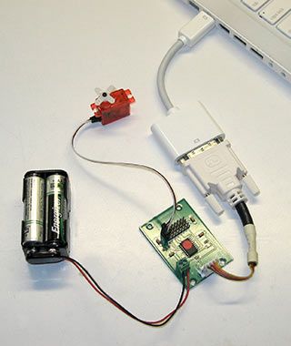

Posted by: aladds on 2025-03-02 02:03:06 A number of projects have used the video card I2C interface for external interfacing. I’ve not seen it done in OS9, though.
World's Cheapest I2C (I-Squared-C) Adapter: Make a sensor interface for your computer for under a buck!Update 6/9/08: After exploring several avenues I've concluded there is no practical manner of implementing this technique in Microsoft Windows. This is not petty OS bashing, I've really bust…
www.instructables.com
