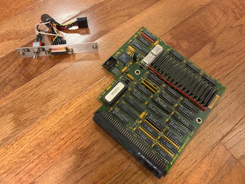

Until I get the working CRT can I use this external video port to test out rest of the computer?
I have this card installed.

No, don't fire it up with a cracked unsafe CRT until you switch it over.
