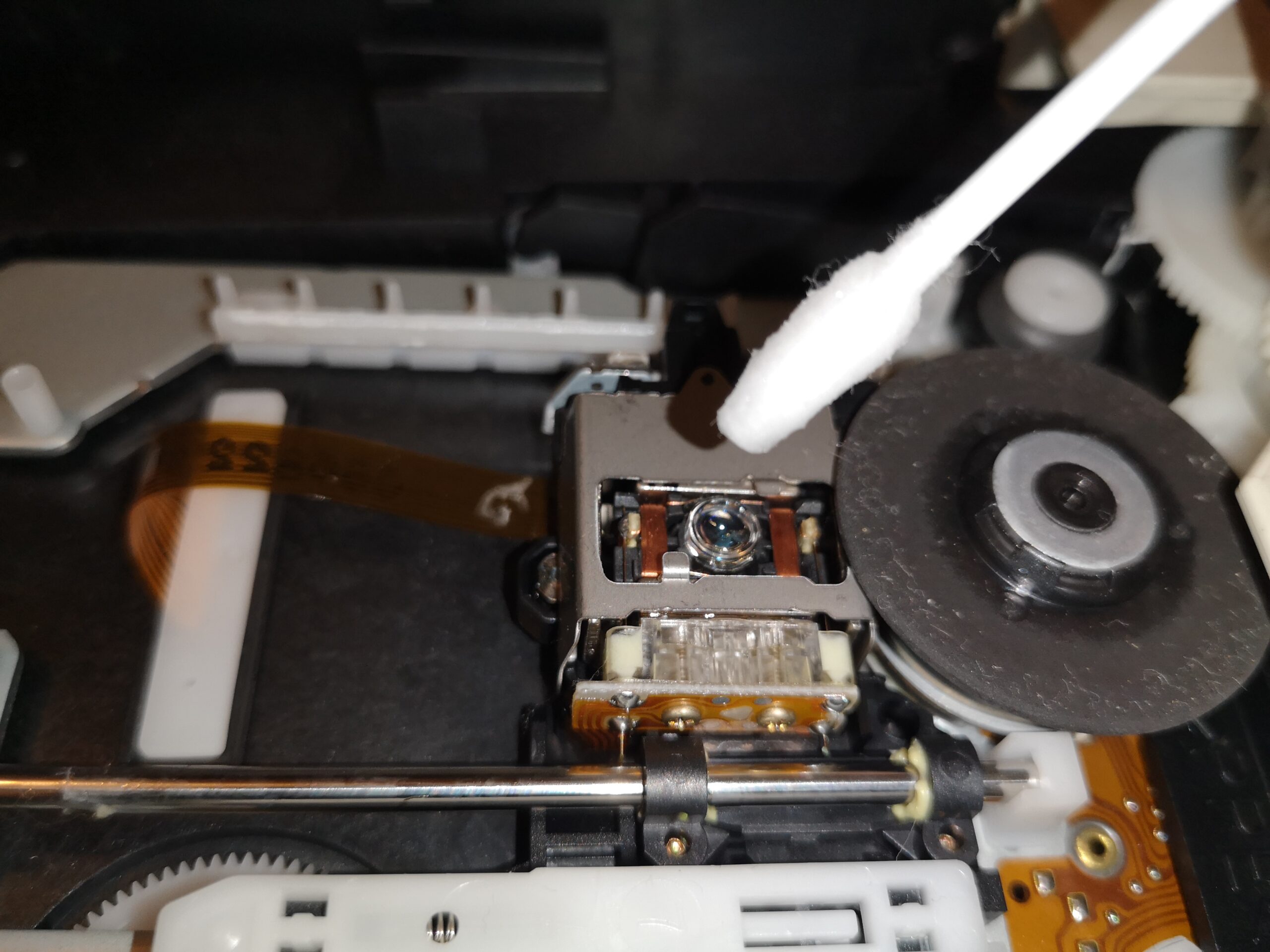

Problem is, the CD drive doesn't appear to mount on the desktop. It looks plugged in, but nothing comes up. The AppleCD extension is active. Dead drive? Doing this often fixes drives :
Cleaning the Lens in a ’90s Apple CD Drive 90s CD-ROM drives frequently struggle to read CDRs (home written discs). Sometimes this can be helped by using another brand of disc or writing the …
stuffandnonsense.elephantandchicken.co.uk
Moving files from ZIP disk to desktop, creates a folder in the ZIP disk (like a second desktop) and doesn't appear to copy to the desktop on the MAC HD. Is there a workaround? Copy them to the hard disk icon, or hold down option while dragging and dropping on the desktop - the latter forces a copy and does so to the boot disk.
One of them plays screen savers Probably in the System Folder>Control Panels folder. Look for "After Dark", or "Dark Side" or... Erm others. Photograph the control panels window and I'll tell you what to move out of the folder to somewhere else. | Posted by: ClassicMacintosh on 2023-09-12 23:32:25 Great, that did the trick. Reads discs perfectly now. Broke another tab (front panel) and had to epoxy it. Also a tab inside the CD (which was a Matsushita). Did the same clean to the floppy heads too. Used the CD drive to move a copy of Stuffit 5.5 to the disk, and archives are now able to be unstuffed! Was also able to move a newer copy of ZIP tools, to format the disks for Mac. However, can't seem to find the option to change format to HFS.
