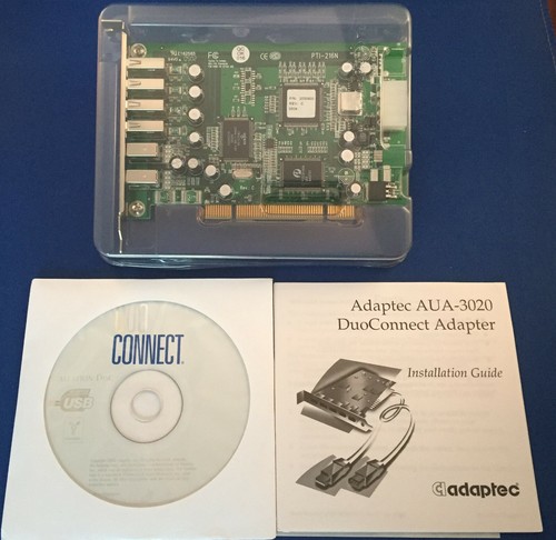

I'd like a USB/FW combo card. Anything to watch out for here? Anyone have experience with these?:
Find many great new & used options and get the best deals for (3x)FireWire & (4x)USB 2.0 Combo PCI Adapter for PC/MAC at the best online prices at eBay! Free shipping for many products!
www.ebay.com
Find many great new & used options and get the best deals for Adaptec DuoConnect AUA-3020 4x USB 2.0 + 2x FireWire PCI - FREE Shipping at the best online prices at eBay! Free shipping for many products!
www.ebay.com
Would I need to hunt down drivers for these? At least the first one looks like it has an NEC chip for USB
As for Ethernet; I have read the RTL8169SC is a gigabit chipset that works with OS 9. They're cheap, so if they work well, figure I might as well go gigabit. I think I gathered I'd need to hunt down the driver though, is that true? Would a 100M chip like the RTL8139 work with OS 9 included drivers?

Would I need to hunt down drivers for these? At least the first one looks like it has an NEC chip for USB No third party drivers needed (but you might need to install the Apple ones).
USB can be an issue, but an NEC chip is exactly what you want 🙂
As for Ethernet; I have read the RTL8169SC is a gigabit chipset that works with OS 9. They're cheap, so if they work well, figure I might as well go gigabit. I think I gathered I'd need to hunt down the driver though, is that true? They work, but sometimes you have to hack the driver and they only work at 100baseT in OS9 (gig in OSX). I can help with that if needed. The driver is on the Mac garden. I'll dig it out if you can't find it.
Would a 100M chip like the RTL8139 work with OS 9 included driver? I can't remember which chipsets work off the top of my head sorry. |

Posted by: croissantking on 2023-09-30 01:23:39
Might buy the 2nd too, tho that one doesn't appear to have an NEC chip. Adaptec should be Mac friendly - I don’t recall any issues with the Agere/Lucent chipset. It’s the VIA chipsets you want to avoid as they don’t work properly with Macs. |
