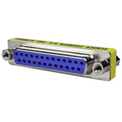

Thanks for your reply. The DB25 end must be female, which are hard to find and I assume is why they are more expensive...Randy ah right. Hum.
You might just get away with a gender bender to sort that :
This Gender Changer Connector is the easiest way to connect two DB25 Male to Male Interfaces. 2 DB25 female connector. Gender Changer. Female to Female Connector.
www.ebay.com
Posted by: rwcooper on 2023-07-27 16:22:03
ah right. Hum.
www.ebay.com
Thanks for your reply. I have the appropriate gender bender. The keyword in your reply is 'might'. I wondered about doing that, but I don't want to damage anything. Termination is simple, I remove the current terminator from the SC20 and add the zuluscsi at the end of the chain as the zuluscsi mini has 'always on' termination...Randy |
Posted by: cheesestraws on 2023-07-27 16:24:09
I've used one of these and it's absolutely fine. It's just like a very very short cable (so long as it's actually manufactured properly, obviously). |
Posted by: Phipli on 2023-07-27 16:25:08
Thanks for your reply. I have the appropriate gender bender. The keyword in your reply is 'might'. I wondered about doing that, but I don't want to damage anything. Termination is simple, I remove the current terminator from the SC20 and add the zuluscsi at the end of the chain as the zuluscsi mini has 'always on' termination...Randy "Might" is because it is 12:23AM, I've been drinking, and I don't trust myself to think too hard.
The listing has a picture of the wiring - it routes pin 1 to pin 1 etc etc, so it effectively doesn't exist in the cable chain. But... given I've been drinking I don't feel comfortable talking in absolutes. Perhaps someone more sober and in a more sensible timezone can confirm for us 🤣 |
Posted by: Phipli on 2023-07-27 16:25:42
I've used one of these and it's absolutely fine. It's just like a very very short cable (so long as it's actually manufactured properly, obviously). Might is because it is 12:23AM, I've been drinking, and I don't trust myself to think too hard.
The listing has a picture of the wiring - it routes pin 1 to pin 1 etc etc, so it effectively doesn't exist in the cable chain. But... given I've been drinking I don't feel comfortable talking in absolutes. Perhaps someone more sober and in a more sensible timezone can confirm for us 🤣 Or @cheesestraws - in the same timezone, but hopefully sober. |
Posted by: cheesestraws on 2023-07-27 16:29:05
I am sober, and far too awake for half past midnight. Oh well...
I've actually got one of these wedged inside one of my SEs, for complicated reasons, so... 🙂. It should be good. |
Posted by: rwcooper on 2023-07-27 16:35:46
The listing has a picture of the wiring - it routes pin 1 to pin 1 etc etc, so it effectively doesn't exist in the cable chain. But... given I've been drinking I don't feel comfortable talking in absolutes. Perhaps someone more sober and in a more sensible timezone can confirm for us 🤣 The one I have is 'wired' the same way. I checked it out with my multi-meter earlier today...Randy |
Posted by: rwcooper on 2023-07-27 16:40:16
I've used one of these and it's absolutely fine. It's just like a very very short cable (so long as it's actually manufactured properly, obviously). Thanks for your reply. When you say 'one of these' are talking about the gender bender? |
