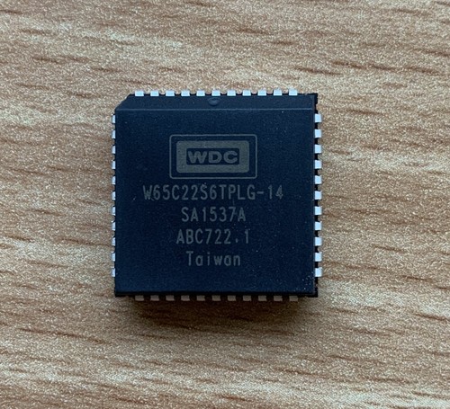

Is any 65C22 PLCC44 chip usable as a replacement for the SE/30 VIAs, such as this one?…

VIA of SE/30 is
338S6523  (11484 -28, -30, -44 etc. ) = R65NC22J (Rockwell) VL65C22V-02QC (VLSI)
Model numbers are from multiple SE/30's on real machines.
I think the closest thing to R65NC22J is W65C22N6TPLG-14, not W65C22S6TPLG-14.
Please refer to P.32-35 and P.50 of the PDF.
A long time ago, I bought one listed as "R65NC22J4 (11484-39)" on Taobao and it worked fine.
Posted by: croissantking on 2023-06-18 03:41:32
I will try the W65C22N6TPLG, it’s available on Mouser.
From the PDF you linked, it appears there are some minor design deviances regarding the port buffers.
I don’t think TaoBao is accessible to foreigners anymore, pity as some sellers currently have the R65NC22J4.

Posted by: croissantking on 2023-07-04 02:21:17
I’ve got the chip now, will test it soon and report back
Posted by: Phipli on 2023-07-04 03:11:56
Hum. Just to warn you, the WDC part is not 100% compatible with older types. I forget the specifics, and the Mac might not use those features, but I know it isn't identical.
Posted by: Phipli on 2023-07-04 03:14:22
There is an 'N' and an 'S' version. You bought the one that is designed to replace NMOS parts, which is probably the right thing to do, hopefully it is happy replacing CMOS parts too.
Posted by: croissantking on 2023-07-06 16:42:37
So it does work.
I mean, it boots up and I can use the computer. Do I need to do any specific kind of tests?

Posted by: croissantking on 2023-07-10 19:51:16
I’ve done a bit of testing. MacTest Pro is happy with the VIAs, and both sets of ADB and serial ports work fine. The internal floppy works too but I haven’t tried an external yet. No weirdness at all during about 2-3 hours’ use. Also just to mention that I tried the new VIA in both locations as my board is socketed.
