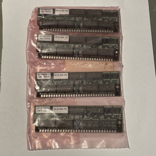

Posted by: 3lectr1cPPC on 2023-06-13 12:11:30 Just realized the IIsi I bought has no RAM SIMMS installed so it’s got the base 1MB. Would these modules from eBay work in it?
Find many great new & used options and get the best deals for 16MB 4x 4MB 30pin SIMM RAM MEMORY without parity 4x8 30-pin Apple Mac PC at the best online prices at eBay! Free shipping for many products!

Posted by: Phipli on 2023-06-13 12:31:40 Thats not easy to answer. Infact, with manufacturers changing what chips they use, Its basically impossible to answer.
The best answer I can do is perhaps, but the probability is better if you get 8 chip simms. |
Posted by: Phipli on 2023-06-13 12:38:43 These look better although confirm they are sets of 4 4MB simms :

Posted by: Phipli on 2023-06-13 12:41:30
Thanks for the help! I’ll get those, they’re cheaper too!
Just curious though:
What would the difference be? Not an expert in RAM by any means. Is the IIsi picky about RAM like the SE/30 is? I take it back - they're 16mb simms, so you'd need 4 sets |
Posted by: 3lectr1cPPC on 2023-06-13 12:51:51 Ooh. So what would one stick do? Do you need 4 matched ones for any to work? Haven’t ordered anything yet don’t worry. |
Posted by: volvo242gt on 2023-06-13 12:59:20 IIsi, like all '030 Macs with 30-pin SIMMs, requires a set of four in each bank (in the IIsi's case, there's only one bank). I ran one of my original IIsi machines with 16MB in bank "B" for a couple years. Made it more useable than it was with the original 5MB. My third IIsi, I put a set of four 16MB SIMMs into it. So, had a total of 65MB. Except for the long wait for the RAM check, it was entirely useable, if a bit pokey, since I was running Mac OS 8.1 on it. Yes, with the Born Again patch used at time of installation. |
Posted by: Phipli on 2023-06-13 13:01:07
Ooh. So what would one stick do? Do you need 4 matched ones for any to work? Haven’t ordered anything yet don’t worry. You need 4 matched sticks. Its a bit of a mess in that era of RAM over what does and doesn't work, but I think macs didn't get more forgiving until the Quadras, and even they didn't like some SIMMs possibly.
4 of these would work :
Upgrade your Mac memory and save money by trading in the original factory memory chips. Includes a lifetime OWC warranty.
eshop.macsales.com
And that would give you onboard RAM plus 64MB for 65MB. |
