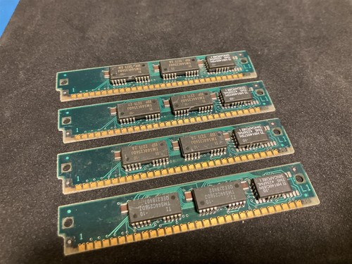

Posted by: mg.man on 2023-05-21 14:24:37 Any good?
Find many great new & used options and get the best deals for 4x 256KB 30-Pin 3-chip Parity 100ns Memory SIMMs 1MB 256K-9 RAM Apple PC UNIX at the best online prices at eBay! Free shipping for many products!

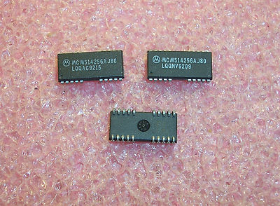

Posted by: mg.man on 2023-05-21 14:27:39 Or if you want a whole bunch...
256x4 PAGE MODE DRAM. 28 PIECES MCM514256AJ-80 MOTOROLA. REFURBISHED 1 TUBE.

Posted by: JC8080 on 2023-05-25 11:47:03
Any good?
www.ebay.com
The onboard RAM is 80ns, even though the specs for the machine call for 100ns. I would be a bit nervous replacing the onboard RAM with slower chips in case there is some reason they need to be 80ns, maybe because they are shared with VRAM? |
Posted by: JC8080 on 2023-05-25 11:51:52
www.ebay.com
There are some good options on eBay, though they do all have quite a few more chips than I need.
