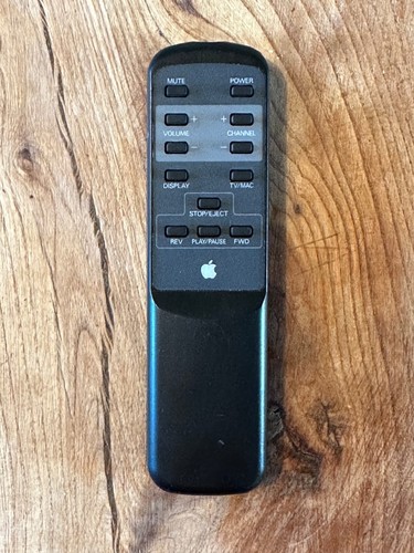

I do have some old cameras and such that have composite output I could try out the card with. I watched the above video and I must indeed agree with what he says - pretty useless, except to mess around for the sake of it. Which, I think, basically summarizes what we all do with our vintage Macs.... except my 5.1 cMP. That is still a full production machine. Which is very impressive, since it's over 12 years old. Don't forget to grab a remote - you can wirelessly power your mac on from over the room!
Random ebay listing, best search for ones with cheap postage to you :
Find many great new & used options and get the best deals for APPLE 6580086A Genuine Remote Control | For MAC TV at the best online prices at eBay! Free delivery for many products.
