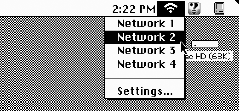

I use one of @Bolle's adapters in conjunction with a GL-AR300M shadow router and the Mac WIFI extension on my SE/30. Works pretty well.....at least, as well as it can with a 68030 based Mac. I basically used the same procedure that someone used here:
I just use the GL-AR300M instead of the (rather crappy) vonnets WIFI bridge.
