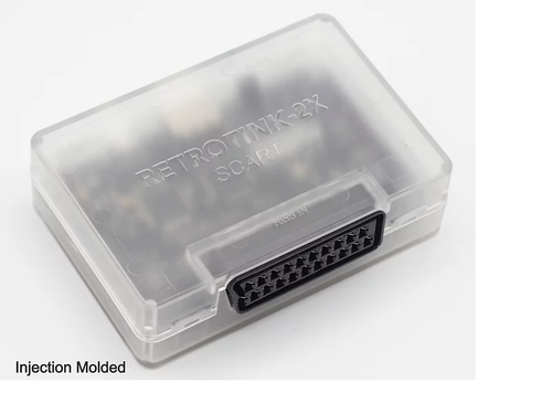

Cool... Since OSSC is suffering from shortages, would a SCART + one of those "cheapos" SCART to HDMI from Amazon (such as this one) would work or does it need to be special (maybe has to support 240p 15KHz input) ? I like the Retrotink 2x SCART, it works well enough for the IIgs for me and I like the scanline option.
Works well with 240P input, I also use it with an Amiga 600.

Posted by: Byte Knight on 2023-05-05 06:43:51
I like the Retrotink 2x SCART, it works well enough for the IIgs for me and I like the scanline option. Thanks for the free advertising! 😉
