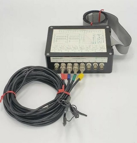

Saw this SE on facebook, has some centronics connector in the expansion port. any ideas on what this is? 1679453442934.png

it looks like a scsi port, but i have no idea what it could be used for.
Posted by: Iesca on 2023-03-21 21:06:05
I'm guessing it's a 36-pin Centronics parallel printer port?

Posted by: mmmlinux on 2023-03-21 22:21:39
were there adapters that allowed for a parallel printer port?
Posted by: Phipli on 2023-03-22 01:22:44
It could be absolutely anything - the centronix is like the dsub or din series ports : they're not tied to a standard. You can't assume it is a specific connector visually. The "if it fits, it works" thing was not valid in the 80s, you could break things like that.
Parallel is one option, it might also be controlling some proprietary hardware.

Posted by: Scott Baret on 2023-03-22 20:54:21
I saw that one too. I'm also guessing parallel printer (I know there were external adapters for people who wanted to connect parallel printers so I'm sure they also made PDS and NuBus cards).

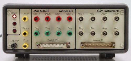

Survey says.
Posted by: Phipli on 2023-04-06 15:25:39
Survey says.
Scientific I/O board. Data logging and control. I see mentions of using it as an oscilloscope, controlling electron tunnelling microscopes and building custom measurement and processing instruments. Shame its missing what it plugged into.
I'd put it into the same category as a National Instruments card, something like either a GPIB or MIO card?
Yeah - I think it was marketed as a cheaper alternative to that kind of thing (?)
Posted by: Phipli on 2023-04-06 15:30:47
Cheaper and easier - "no programming".
http://www.gwinst.com/macsftwr/html/ss2_summary.html

Best I could do with wayback machine. I wrapped all the downloads in a zip for neatness.
Posted by: Phipli on 2023-04-06 16:19:47
MacWorld Article
