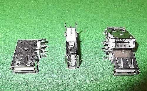

Do you want me to send you a couple of ports? I have a box like this if I can find it.
Posted by: croissantking on 2023-03-09 14:01:47
Sure!
Posted by: Phipli on 2023-03-09 14:07:49
Or possibly these, price is pretty close to the cost of postage :
