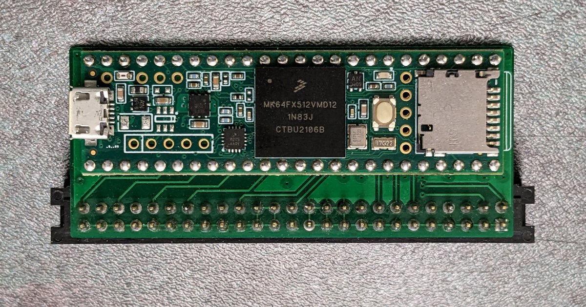

GreenSCSI

Posted by: saybur on 2023-02-19 07:06:32
Another SCSI emulator without bus transceivers, sigh.
I get that it makes them cheap and they work well enough without anything else on the bus, but man I wish the people who sold these were more up front about them being totally non-compliant with the spec. If you start attaching real devices, or real terminators, you're going to eventually blow up the MCU on these - they're not designed to sink the high currents SCSI uses.
Caveat emptor, I guess.

Posted by: Paralel on 2023-02-19 09:42:47
I agree. If these are out of spec, they need to be very upfront about that, as the general assumption is going to be that things are compliant with spec. unless otherwise noted.
