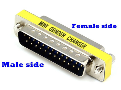

Posted by: Phipli on 2023-02-09 00:34:25
It looks like it doesn't fit into the rear SCSI port.
Often, one or two of these is enough. I think one would do in your "case".
Posted by: cheesestraws on 2023-02-09 02:09:44
I like the way those say GENDER CHANGER on them in big letters then aren't a gender changer 😛
Handy things to have around though.
Posted by: Phipli on 2023-02-09 02:54:13
Genders sustainer? Gender offsetter? Gender piggy-in-the-middle?
Gender pretender?
Posted by: rikerjoe on 2023-02-09 05:31:58
This is what I use to connect my DB-25 BlueSCSIs and SCSI2SDs to my Centris 650. One was enough to clear the lip, barely. A second wouldn’t hurt on the clearance front.
Posted by: 1200XL M.U.L.E. on 2023-02-09 13:07:50
"Gender benders" and cables. I ordered both from Amazon after my post last night. 👍
If Rabbit Hole Computing couldn't design around this, then I wish they would have mentioned this in big and bold letters on their website. I would have bought a cable and one of those quasi "gender benders" from their site if they offered for a only a dollar or two more.
