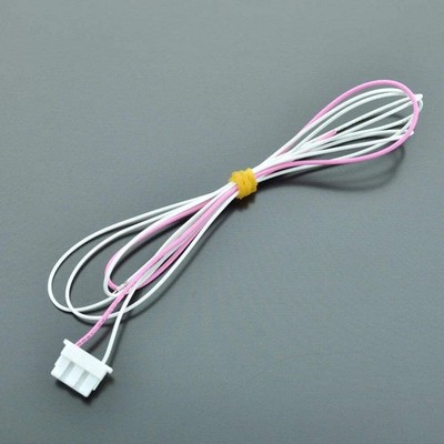

And the same vendor also is listing the plug which seems to be the one that Apple is using. It's a JST 3 pin connector (only uses 2 of the 3 pins). They have it listed here:
Thoughts @croissantking @3lectr1cPPC. I think it should work? I can probably model end caps for it and 3D print them in TPU. About $17 USD for the tube and $4 for the connector. Connector is kinda expensive but can't complain if I'm only going to buy 1. For $21 plus $7 shipping, might be worth trying to see if it works?
Posted by: 3lectr1cPPC on 2025-11-23 20:34:05
Looks good to me. I've done a handful of CCFL swaps but I haven't ordered any new ones yet. Don't see why that wouldn't work though.
