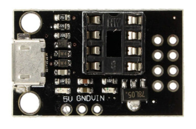

Posted by: trickydee on 2023-09-30 15:50:43
Hi @Phipli
I purchased this board from eBay :
The only other boards I have are NodeMcu V3 ESP8266 's.
I did see a number of article on using an Arduino to program the board using ISP. Which is the best option here? Arduino or a TL866?
I did need an excuse to buy a TL866 as I wanted to burn some eproms 🙂

Posted by: pgreenland on 2023-09-30 16:39:11
@trickydee I've been using the a T48, a slightly updated version of the TL866 I think. I bought it with the exact same excuse as you - programming some GALs and EEPROMs for a Bolle SE/30 replacement logic board. It programs the ATTiny's just fine too.
You're right in that the ebay programmer would require a special bootloader on the ATTiny. It's less a programmer and more a breakout board for the USB...cool nonetheless.
I used a USBasp originally which work pretty good - USBasp Programmer cable & adapter FW V1.06 USB AVR ok with 2560 TPI ATTINY
An Arduino can emulate a programmer and I've used them successfully for this in the past, but it can be quite a faff.
I'd go with either a USBasp or TL866.
@Phipli is spot on in that there's two parts to programming the ATTiny. The firmware itself, which it sounds like you've managed to build ok and the fuses. They're configuration flags for the microcontroller which in this case configure it to run from its internal clock and repurpose the reset pin of the MCU as a general purpose output, which can then be used as part of the communication with the mac.
The TL866 may (haven't been able to confirm) support high voltage programming for the ATTiny. This is required if you want to program the chip a second time. Once the fuses have been set and reset line repurposed the standard programmers aren't able to talk to it anymore. You need a high voltage programmer, which zaps the reset pin with a high voltage, forcing the chip into one of its programming modes.
The drop in ATTiny replacement hasn't got all that many miles on it unfortunately. Would be great to hear how you get on using it in your IIGS.
Phil
Posted by: trickydee on 2023-09-30 18:45:14
Thanks you both for the replies.
@pgreenland - Yes I saw the requirement around the high voltage programmer, I don't expect that I will reprogram once I get the code loaded.Even if the chip is not accurate it will be better than the non-functioning unit previously in the machine - where only the pram worked the clock had no 1sec pulse at all.
One final question before I purchase a T48 or TL866 - do I need any adapters to fit the tiny85 into the programmer ? - do you use a breadboard ? or will it's pins reach?
