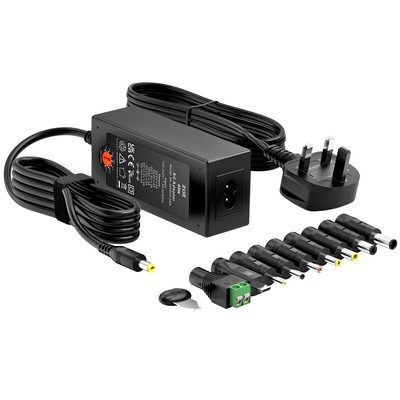

Posted by: ClintonGoodfellow on 2023-01-21 09:43:07 That’s a great tip for opening the cases, I’ll be sure to give that a go! Having a hard time finding a 7.5v 3a psu. Any ones I find just seem cheap.
Zolt 45W Universal Power AC Adapter 5V 6V 7.5V 9V 12V 13.5V 15V 1A 2A 3A Power Supply, AC to DC Universal Adjustable Adaptor for Led Strip Light TV Box Tablet Speaker and more Electronics 67
www.ebay.co.uk
This was one I found, if you look at the pic it says it can do 7.5v@3a, but who knows to be sure? |
